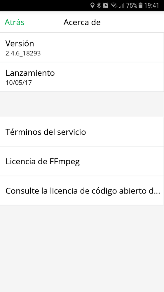

Where did you get the previous version?
@Ulala wrote:
I have installed an earlier version and it works perfectly
