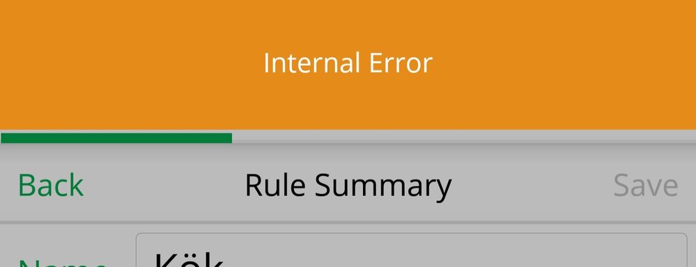

I was changing the mode configuration and when saving got some internal error (software or API) notification in the header of the app.

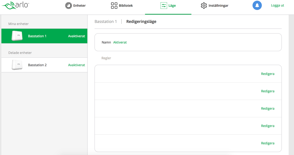

When i log in from a computer i cant see my cameras under the "Activated mode". It´s just blank. But i do see and can click "Edit" to the right (see attached image).
When im trying to edit the rules, the save button remains light grey and i can´t change anything.
So i cant change mode on my phone, and i cant edit my modes on a computer.

I may have a slightly different error than described here. But still I can not change mode. As you see the screenshot of the mobile, I have the mode button, my app is trying to get mode. On my computer it's about the same, but I can change mode, but not the different rules. However, I do not think the mode changes, because the cameras click when I walk by themselves when mode says they should be off. Yes, Netgear - where is the solution? I think the IT people at Netgear do not have the knowledge enough to handle this.
