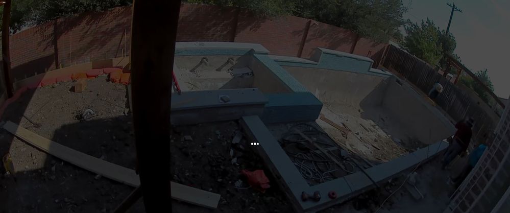

Live View: 3 moving white dots
During live view using Chrome on a PC desktop I will often get a darkened live view with 3 white dots in a "moving" motion like it's trying to load... This is even after live view is successfully connected.
Sometimes I can still make out action in live view even during a darkened screen with the dots, other times I can't tell.

When watching my live cameras, they seem to be constantly "buffering" (if that's what it's called?)
see enclosed photo.
What causes this?
How to I fix it to stop doing this?
Suggestions?
Thank you.
