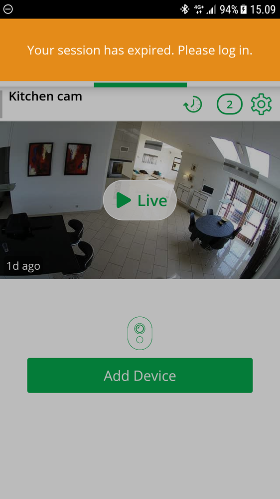

YEP exact same issue after iOS update of the app to version 2.4.7. No longer recognising when we are away or back home. If device is showing out of zone then it will stay out of zone even if we arrived back home and vice versa.
The app does not seems to be running in the background. If I open the app, minimise it, wait few mins and open it again, it went back to beginning where it will try to log me in from start.
Netgear are you listening, fix your freaking app. and Yes I have done all the "disable/enable" devices steps and have even gone as far as reset to factory default and resync all my cameras and resetup GeoFencing.

Yes, same issue with IOS also. run the app and few mins later try to open the app, it goes back to login screen and ask for login again.
GeoFencing needs the app to be running in background to be able to works which is not the case after the latest update.
