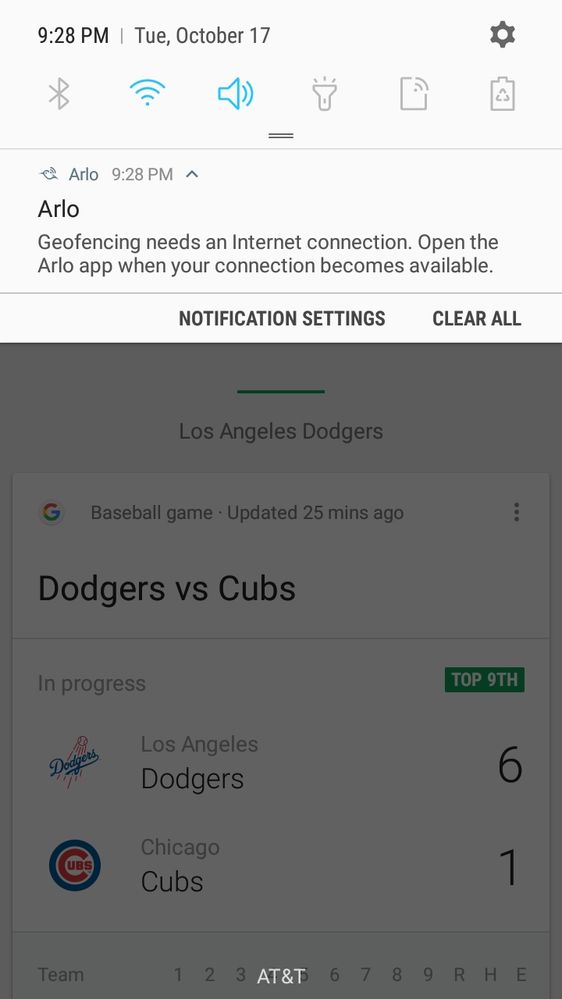

Here's the notification:
Geofencing needs an internet connection. Open the Arlo app when your connection becomes available.
