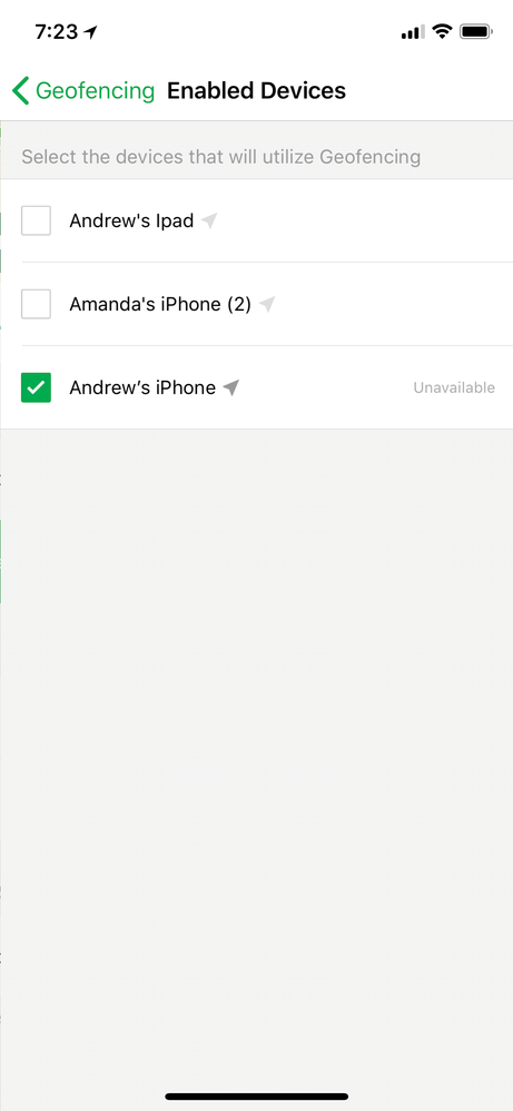

I was having a geofencing issue on my phone, I will explain my exact issue. Then I will explain what I did to fix it.
I had geofencing configured for two phones. My phone is the primary account, my wifes phone is shared with admin access.
Geofencing was working for my phone, arming and disarming as I came and went. Geofencing was NOT working on my wife's phone.
In the Arlo app, it showed my wifes phone as "In Zone" when she was home, as it should, but geofencing was still not disarming because I was away.
I went into the Arlo app on my phone. I unchecked both phones in geofencing and saved.
I closed the app on both phones. (I texted my wife and asked her to make sure it was closed on her phone)
Then I reopened Arlo, went back into geofencing and checked both devices, and saved. I set geofencing as the mode.
The Arlo then set my cameras to Away mode, I noticed my wifes phone status was "Unavailable"
I closed my Arlo App. I texted my wife to open her Arlo app.
As soon as my wife opened her Arlo app, I received a push notification on my phone
"Geofencing at Home is now set to Home mode."
Success!
@joefanwrote:I fixed my geofence problem by changing the name of my iphone, because the name was incompatible with the Arlo App. My iphone's name (which can be changed under "Settings, General, About") was "Joseph's iphone 6 plus." I changed it to "Joesiphone6plus" Basically, I made it shorter, removed the appostrophy, and removed the spaces. Geofenceing works now.
Before, with my original name, I was unable to save the geofence settings for my phone. When I added by wife's phone (which is just named "iphone") I could save the settings, but the app showed my phone as "unavailable." So the geofencing was only recognizing my wife's phone.
Also, in the many times that I was trying to save the settings I saw an error that read something like: "...32 characters...no special characters..." etc. But the error did not specify a problem with the name of my phone. And because the error did not appear each time I tried to save the geofence settings, I thought it was a glitch and ignored it. Once I got my wife's phone working I just kinda figured out that the error was in reference to my phone's name. I changed the name, and it all works now.
Renaming my phone fixed my issue, too. Come on, Netgear, pop up an error, or something, that tells the user the phone name is incompatible and to change it.

Consider refreshing your enabled devices within Geofencing settings. Disable all listed devices, save and then enable the devices again.
Log in to your Arlo Account (the primary) and navigate to Mode > select your Arlo system > edit Geofencing > click "Enabled devices". Toggle all of the listed devices off and save. After you have finished saving, navigate back to "Enabled devices" and toggle all desired devices back on and save.
