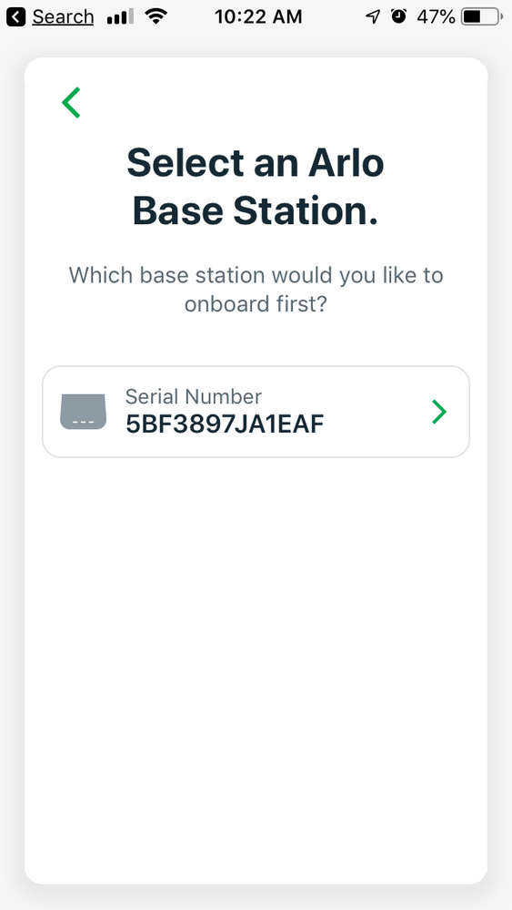

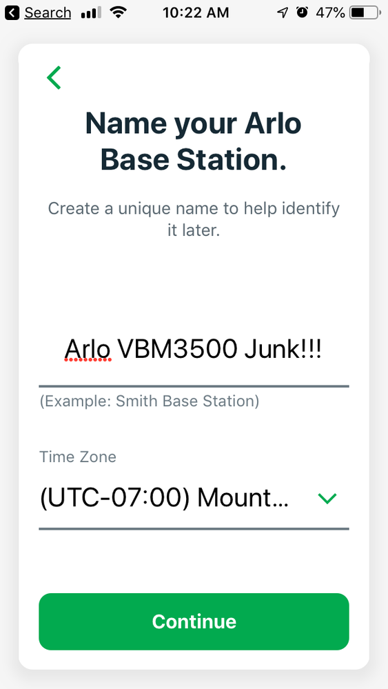

I cannot get past the setup of this base station (VMB3500, part of the VMS3330 security system). The power and internet lights are both green (camera sync light is amber). I am able to begin the setup process,, and the base station is recognized, but the process fails after I try to assign a name to the device. When attempting the base station setup via my PC, I get the error message "Aria Account creation failed." When I attempt it through the app, I get "We're sorry, Arlo is currently unavailable. Please try again later."
Neither of these error messages are remotely descriptive. This is a new setup and I've factory reset the base twice. Anyone got any solutions?

After all of that multiple times I changed all my setting back to normal on firefox and chrome. I have changed my router settings to maximum security (not opening the ports). I have tried to do it at 1:30am when it was raining in California. I had the IOS and computer going finding the base station, when I got the errors I would just keep clicking. On my computer I finally just named it one character, it then asked me for an email. I tried to put in the one I was using and it would not work. I then put in a new email address and it went through the sign in as a new user. After all that it worked.
So I am not sure what caused it to work. I can tell you that you do not need to open up the ports on your router. You may only have to put one character as the name. You may have to wait till early in the morning when there servers are not so busy. After all that I am pretty sure it was a Arlo issue. Not the easiest thing to setup, I will never purchase this again. After the issues and reading how many people have problems it is ridiculous. Most post say it is your router but it is not, I have run test with my router secure and I have no issues.
