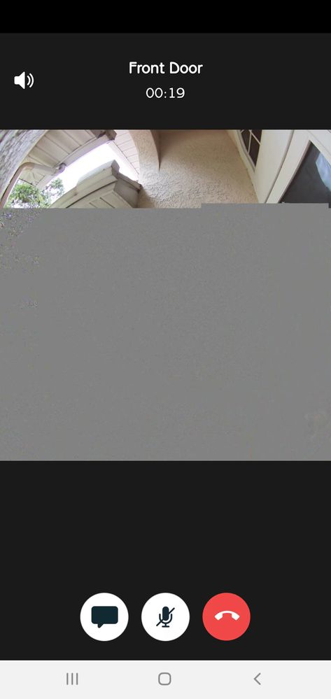

I can answer, I can talk and hear, But no video is showing - only gray screen with rolling circle (like trying to load something). This has been like that for almost a year now with the Audio Door bell. And now the VideoDoor bell doesn’t show video.

The live feed takes A minimum 3 minutes ‘connecting’ (sometimes up to 6minutes) before i Can see live.
When the doorbell is pressed we do not get any live feed and no audio either.

- It’s still taking minutes to connect to live feed
- when the doorbell rings it takes about 5 seconds to respond on my phone
- the screen shows gray/green or the very few times the picture comes up it freezes
- the audio barely works
