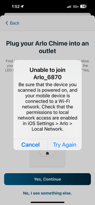

I keep getting this message ever time i try and install my chime 2 to the system. I can i fix it? As you can see happens right at the end of the process!

The light 'fades' white as described. Then, as pictured, it asks if I want to join 'Arlo 8797. This 'wifi network' doesn't exist (and, to be clear, the doorbell is on the '2.4GHz' wifi NOT attached directly to the Arlo Base Station.). There is NO OTHER OPTION given. And then (obviously) it fails and then asks if I want to try again. The whole system (base station, five cameras, doorbell etc) has cost me £1200 and it seems absurd that it fails like this. (The doorbell has already fallen off the network once in a week.)

In my case (and everyone seems to be different from the forums I've read) it was solved by downloading the Arlo Secure app from the app store on my wife's iPhone 14 Pro. Logged in and the Chime 2 just went through the whole process like a dream. There're 10 hours of my life I won't get back!
There is definitely an issue with some phones and specifically, my iPhone 15 Pro Max.

I’m experiencing trouble connecting the Chime 2 with any Apple product.
mainly the in my case iPhone cannot connect with the wire free network wich the chime sets up during installation/connection.
think I’ve succeeded only one time but then after I had set the name of the chime (in app) I got an “integration error” and the chime couldn’t be setup anyways.
But mainly error is that the phone cannot connect to the network wich the chime 2 sets up during “installation”
I’ve tried with both phone and tablets from Apple and it always fails setting up.
Luckily I have access to android phones too and setting up Chime 2 with these phones (android) is always a success. Done it many times and it works.
You need to fix either the app for iPhone or the Chime 2 firmware. Seems to be some restrictions that iOS won’t grant access, because with any Apple product you won’t be able to install the Chime 2.
I have done anything I possibly can do on my iPhone considering WiFi setup but still I can’t setup Chime 2 with an iOS device.

I scan QR code. I plug in device. Then it says "Please wait..." for a really, really long time. Then it says "Unable to join Arlo_2605; Please make sure the chime you scanned is plugged in." Support was useless as usual. And I mean, I've contacted support over a dozen times for various things, and they have helped 0% of the time.

The base stations do have a closed wifi network that you can't join. But the chime 2's network is just a temporary one created for onboarding, and it shouldn't have (or need) a password.
