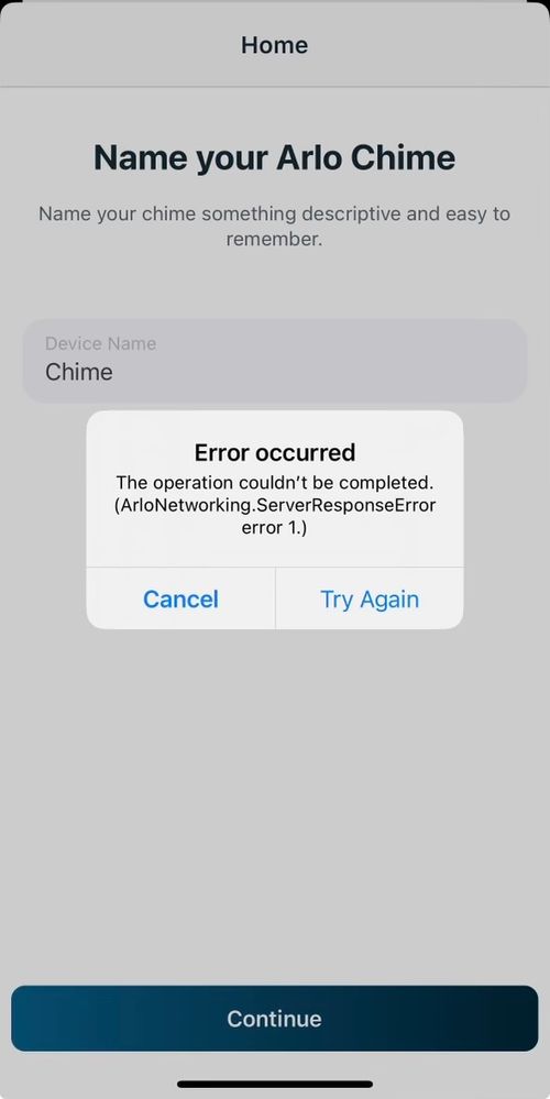

This is as far as I get, a frustrating useless piece of junk

It's not a new purchase, had it connected before even then had to use an old iPhone 11 to achieve it as my then iPhone 14 was having the same problems as now. The iPhone 11 is long gone so that's not an option.
It should be the simplest operation

Agreed. Far too many problems reported here with onboarding.
But your error looks different from the others (nothing about not being able to connect to the chime wifi, it is failing later on in the work flow).
When it fails, are you seeing the chime 2 on the Eero's attached device list?
Yes it appears on the Eero device list as connected but the white light is still blinking and not solid as it should be
So it is failing differently.
Did you remove the chime 2 from your Arlo account before onboarding it?
Have you tried the hardware reset for the chime 2?
Yes it was removed from my account before and have tried many resets
I guess it could be a hardware issue. But the error sounds more like something in the Arlo cloud.
The problem is with the chime not the iPhone
FWIW, your problem is different from @SEMTA's - your's happens later on in the workflow, and is a different error message.
