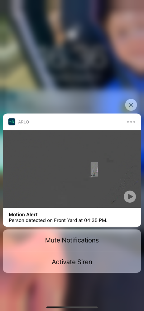

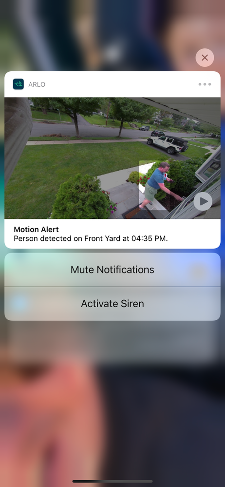

Good evening everyone!
Over the last couple weeks, more and more of my cloud library recordings have a lot of solid gray color on them. I still receive the correct smart notifications on my Lock Screen. Additionally, sometimes the recording will go from working to almost solid gray screen. Or other times it’ll start in an almost solid gray screen and go to working again. This happens in my clips that pick up motion. It happens to both my Ultra cameras, but never at the same time.

After looking into further troubleshooting, it 'seems' this only happens during the day, when it is sunny and hot out.
It does not happen in the early mornings or in the evening once the sun is going down.
Any help from the Arlo employees would be greatly appreciated (as always)!! Can you please check on my open case or confirm if the very hot part of the day is causing my new problem.

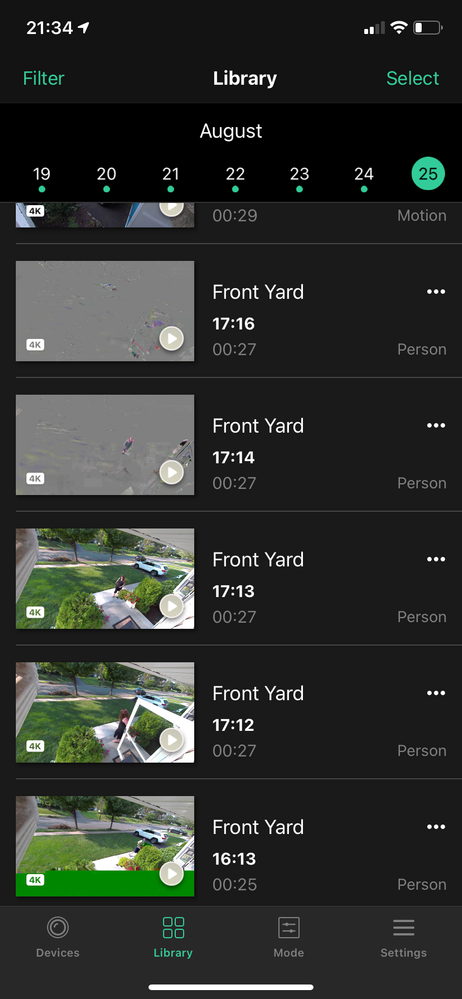

Join the club unfortunately, I’ve been dealing with this for over a month!! See my Arlo app screenshot attached.
tickets open and actively staying in touch with support.

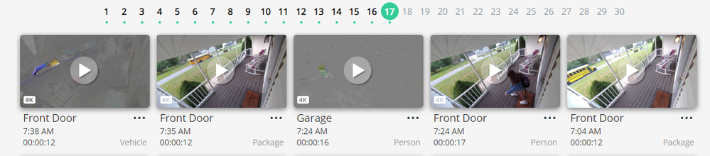

Count me as another that has this happening just recently. I have an Ultra 2 system, and it seems that randomly some of the cameras will show the snapshot image of the video with gray/green artifacts - pretty much like the software used to extract the image from the video isn't working properly. Playing the video and it looks just fine - only the thumbnail image is corrupted. Here are some samples from just today - sometimes the camera is fine, then it isn't, then it is again. The image appears this way on my iPhones, iPads, and the website.
I'll add that "Package Detection" seems to think a school bus is a package. LOL.
In my case, this started happening on 9/10/2020. Before that this never occurred.
