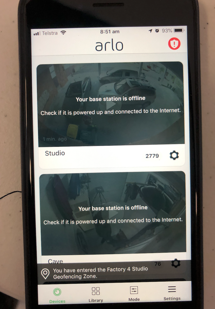

As of this morning (and after 30 mins on phone support + 3 further emails last night) , we now have 2 devices showing correct status (iphone and oppo android) however one device (iphone) incorrectly showed "in zone" overnight.
On checking the app on the device, arlo says "your base station is offline" and simultaniously displayes "you have entered the geofencing zone"
Qitting and relaunching the app has no effect and still displays as base station offline.
See attatched image.
Have reported all to tech support and am waiting for a reply.
