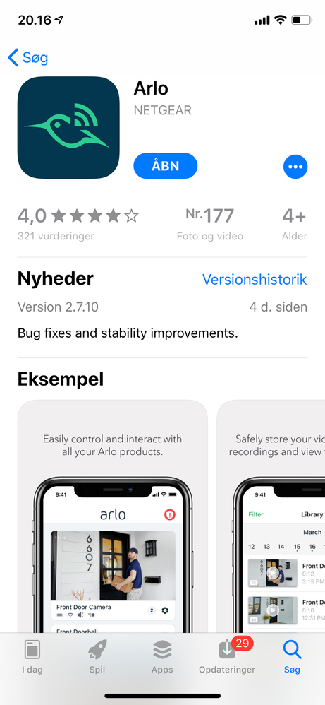

I updated to 2.7.10 4 days ago, testet it and found it was still not working. On the status page you tell US to look at, your development team types that geofence issue has been solbes 2 days ago, but there is no new app available in app store, and firmware in all my 4 basestations is still the same as of 24. Of May. = problem still persist.
