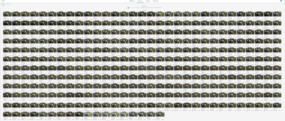

And over 280 of them are audio triggers, I've attached a screengrab of my library for today and it's only 15.37!
