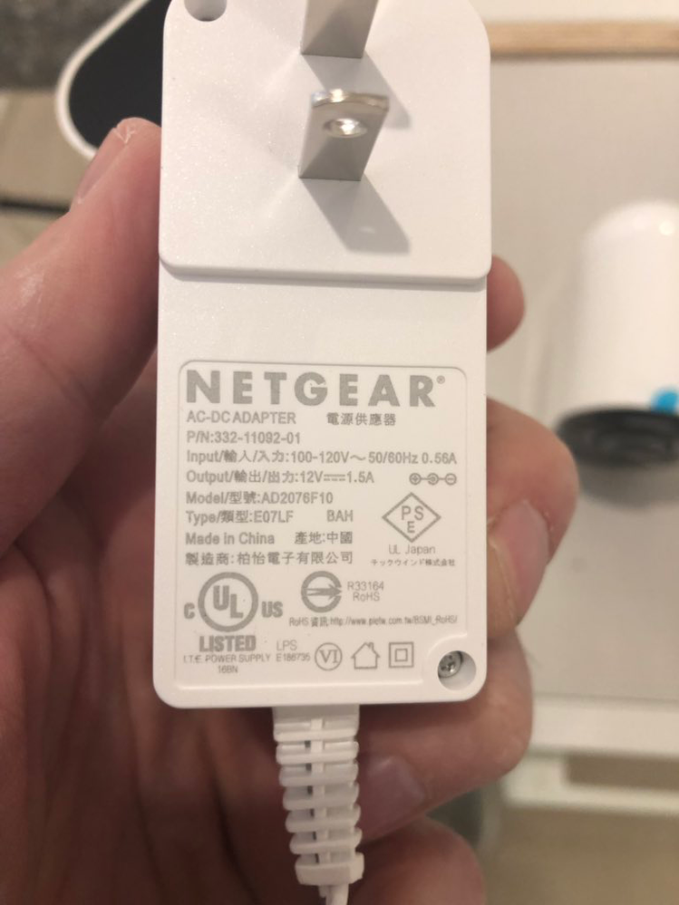

I bought an Arlo Ultra 2 Cameras bundle last week at Best Buy in US to be installed on my beach house in Brazil where the local voltage is 220v, and despite it's labeled 120v, the power supply is plugged in a 220v outlet.
Same here. Got a package from the USA last week.
Adapter for Ultra Hub works fine at 240 volts.
Just another user
Are you positive that I can plug this on a 220 volt outlet ?!
No. But I have received three or four 120-volt adapters from Arlo and Netgear. (Even Arlo stuff still says Netgear on it.) None has gone bang when plugged into 240 volts.
The adapter with the Ultra Hub sent to me from the USA sits beside me with a UK/US adapter plug. It says 120 volts but works at 240 volts.
Guess what? The serial number number is AD2076F10 and P/N: 332-11092-01.
I worked on the principle that even if it does blow up I have lost nothing. Just a useless adapter. It is easy to find a generic replacement.
Just another user
Yes! Thank you!
I can confirm that it actually works!
I succeeded to plug it in Israel (220v).

That makes two of us, one in Israel the other in the UK, successfully using this adapter to power the hub on 240 volts:

After a few days the ac/dc adapter stop working.
The good news is that I bought a new one in radio jack like shop (220 to 12v 2.5 amp) and the base is back on business.

I have done this with quite a bit of Arlo/Netgear stuff. I have yet to have a power adapter fail on me.
Try it at your own peril but what have you got to lose? Test the adapter before you plug it into the Arlo hub and see what happens.
Just another user
Any idea on how to get a replacement that works in 220v countries??
I am surprised that it blew up. I have used several Arlo/Netgear 120-volt adapters on 240 volts. Not one has failed.
Any generic adapter will work.
Look for the right volts, enough amps (more is fine), and a tip that will fit.
