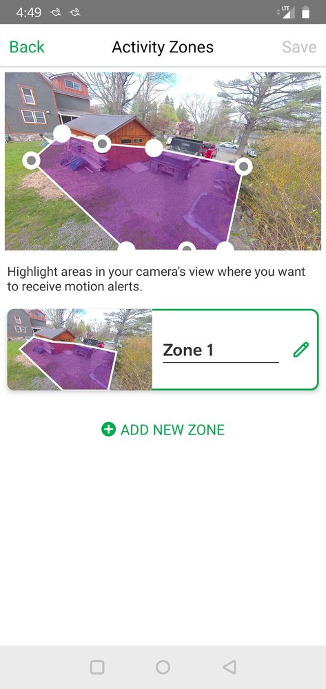

One of my cameras is set up at the front gate of my property looking toward the road. Its a county road so probably only one car per every few minutes. The road is 60ft from my gate so i need to utilize the activity zone to capture only gate movement and movement on my land. I have tried different size zones down to about a 2ft by 2ft box 100ft away from the road. I have also adjusted the sensitivity down to 5%. With both of these settings its still going off with cars driving by.
I read on the Arlo website you have to either have a Smart Subscription or the camera must be wired to power for activity zones to work. Since this camera system is only 1mo old, I show to still have the free Smart 12mo Subscription. I meet one of the requriements for Activity Zones to work yet they dont.

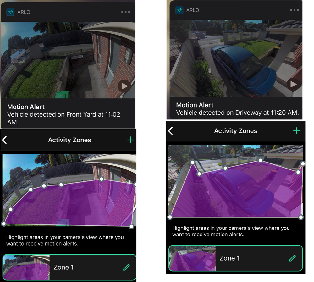

I have 4 arlo ultra cameras around the world and an arlo subscription. Since last week the activity zones of the cameras have stopped working, loggin every single movement, resulting in hundreds of notifications and daily flat batteries.
It looks like this co incited with an issue that was going around earlier, where cameras needed to be added to the subscription via the Arlo portal (ridiculous this can't be done via the app.)
I have already removed the battery from each camera
reset the cameras
reset the base base station.
It is driving me bunkers, whist I am paying for this service. Are there any solutions out there for it or does have anyone have the same issue?
