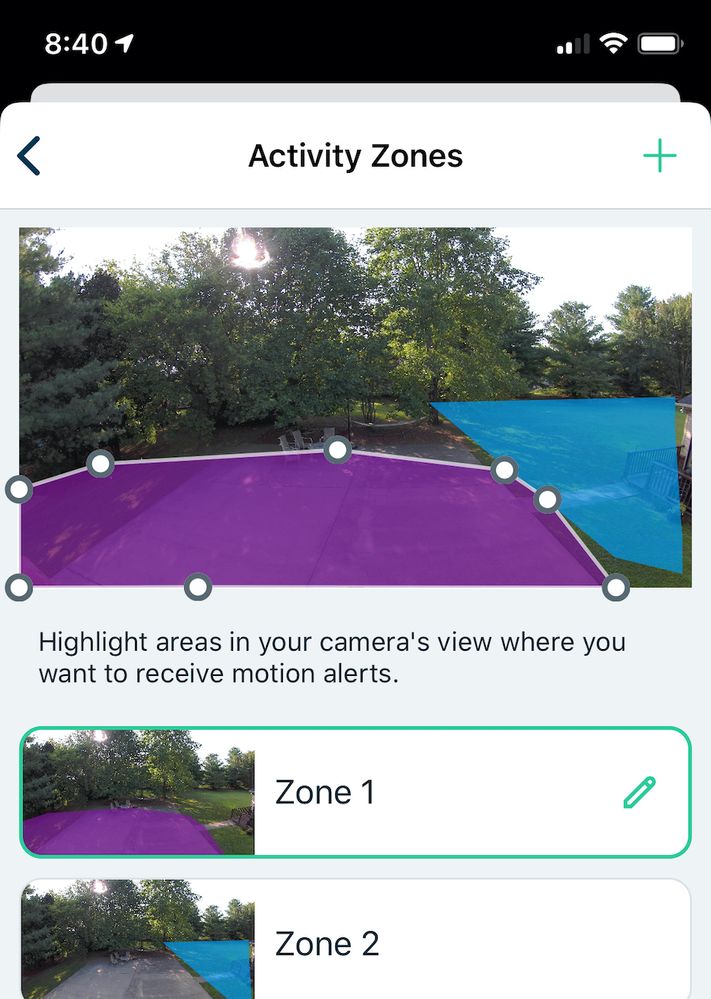

You can see the zone I’ve set in this image. It includes my driveway. Shouldn’t the Arlo 2 Ultra see me when I walk myself and maybe the dog down the driveway? It does not and doesn’t seem to alert to anyone who walks in the driveway. Kind of defeats the purpose! I must be doing something wrong but don’t know what. (And the photo won’t display. It’s an image from the app of the motion zone I’ve set that includes my driveway. )

These are the zones. Someone can walk through the purple zone and it won't alert. I can try to turn the sensitivity more toward the standing still man but then I fear too many false positives. I will already see alerts overnight and when I look at the video all I see are bugs.

1. Your images show a brick wall or sill at the bottom of the field of view. The sill may be obstructing the motion sensor. Try installing the camera on a mount, away from the sill, so there is nothing close to the camera that might obstruct the motion sensor.
2. Your images show the camera is mounted so that about half the image is above the horizon. These means that half the image doesn't include the area where motion will occur, which is a bit of a waste. It also means a large portion of motion sensor's field of view is directed at the sky, which could reduce the sensitivity to motion. Try aiming the camera at a downwards angle, so more of the motion occurs in the sensor's field of view, and so there is less sky in the field of view. I try to limit the amount of sky in the image, as the sun can affect the motion sensor as well as the image quality.
3. It would be helpful if you could post a photo of the camera itself so we can see how it is installed. It looks like the cameras may be aimed horizontally. If the cameras are high up, they will need to be aimed downwards to maximize motion detection range. Also, placing the camera on the second floor will increase the distance between the camera and a person on the ground, so the detection range will be reduced compared to mounting the camera lower on the house.

I hear what you’re saying about the positioning but when I installed them I made sure that I used the “camera positioning” device utility. That provides a grayed out area at the top to and none of the motion area is in there when I check it. The gray area is all sky and I don’t want to detect motion in the sky!
The window sill might be something for sure. I would have thought that as long as the motion is in the area defined it would work.
