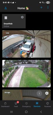

Hi @ShayneS ,
So it seems they have fixed the unreachable error however I am having issues with Live view, it's no longer 4k and it's all Pixelated.
4k is Selected on each Camera settings
I even restarted my Smart hub and no luck, also I have noticed that my Dashboard live has some of the picture cut off
unlike the devices live section.
Dashboard section:
Devices:
