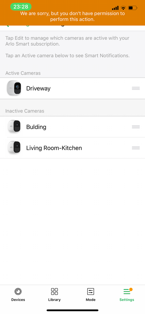

Same here, I moved some cameras down to the "inactive" section of "Smart Notifications" but when I try to move them back to the active area I get the "do not have permissions error".
Also, even though I have an Arlo wirefree camera in the "inactive" area, it DOES still send smart notifications.
So all in all, this part of the system is not working for me.

I have now tried iOS, Android and web browser but all fail to activate cameras due to permissions error.
Since cancelling you Smart service and re-subscribing fixed the problem, it would appear that somehow our accounts got messsed up. I guess that is the next step for me as I have tried everything else.

Ditto here. I had no inactive cameras in Arlo Smart on the web site and couldn't drag them to active on the app. I had an Arlo Smart Elite subscription. Also, it said I was allowed 15 (vs 20) cameras. I remembered this solution and downgraded to Premiere and then back to Elite. I was charged on a pro-rated basis. My max cameras changed to 20 and all of my cameras showed up in the web as active. My cameras also moved from inactive to active on the mobile app when I logged back in there.
