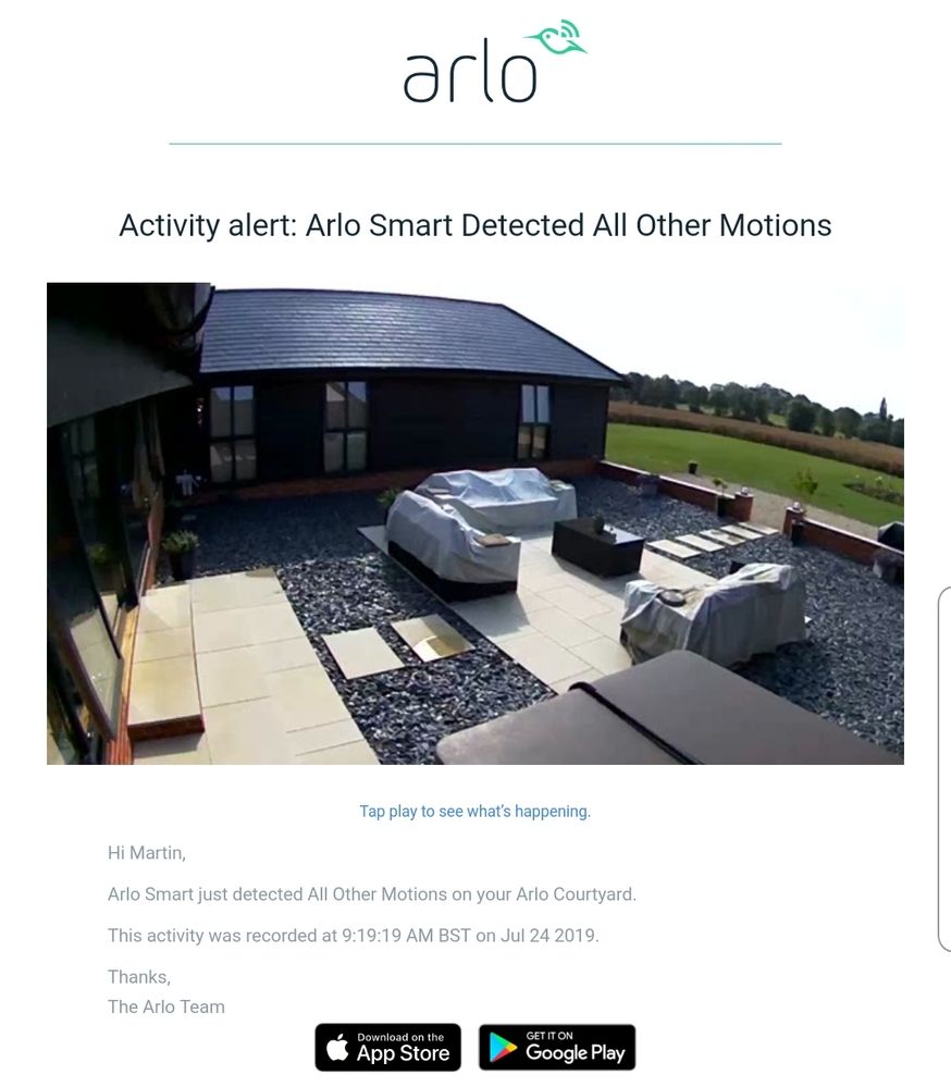

packsorted
So spoke to soon - got a Arlo Smart Alert email for "All Other Motion" despite the only Smart Notification selected being "Person"
Removed the camera from the app, removed the battery for 30 secs, replaced and re Sync'd. So now lets see if it gives false alarms. Looking back at the last few days it does seem to be this camera is the one playing up mostly

packsorted
@szinski - i get still emails for all the Smart categories regardless of smart settings however i only get notifications for the selected ones. Means i can have the Arlo app set to ignore Do Not Disturb so if anyone approaches the house in the middle the night i get an alarm from my phone.
