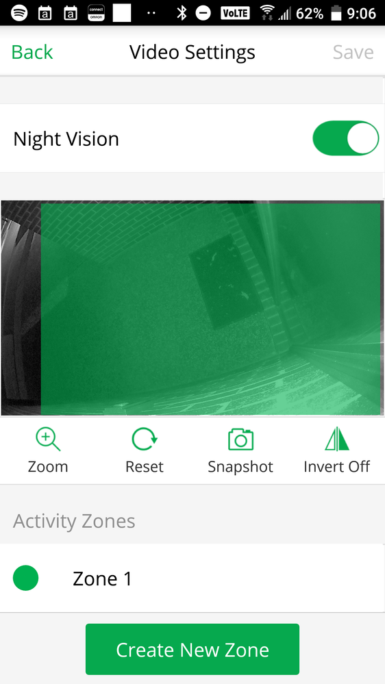

My camera is connected to mains power and the zone appears to save correctly. I have reduced the video sensitivity for all modes to 70% and trialled different zone areas and camera views.. Movement outside the zone is still picked up, particularly at night. The camera is rotated 90 degrees from the normal orientation to provide the best field of view. I've have resynced the cameras and reset the base station with the same result. I have another camera which does enforce the zones, ie doesn't record outside the zone. I would really like to use the capabilities of this camera but so far it's not worked. Any ideas?

kazowie,
The zone in your screenshot appears to cover almost the entire field of view. Have you tried reducing the size of the activity zone as a test to see if you're still experiencing the same behavior?
kazowie
Hi James,
thanks for the reply. Yes, I have cut the zone area to about half of what's in the screen shot and it still has the same behaviour. Obviously the camera position has an impact, but I want to use the zone to get the target area (ie the footpath) but capture a wider view (which includes the road) to actually get footage of everything.The orientation of the camera (ie. at 90 degrees) means the PIR sensor is at its most sensitive but the capture area forces that. As I mentioned, the sensitivity is lowered and there are more video captures at night. Despite trying many combinations I can't find a setting where the zone is actually enforced.
