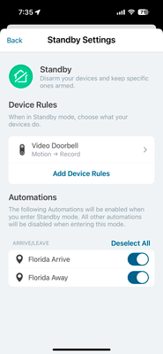

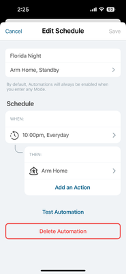

These will work for the schedule (although you'll need to use desired times instead of sunrise and sunset)

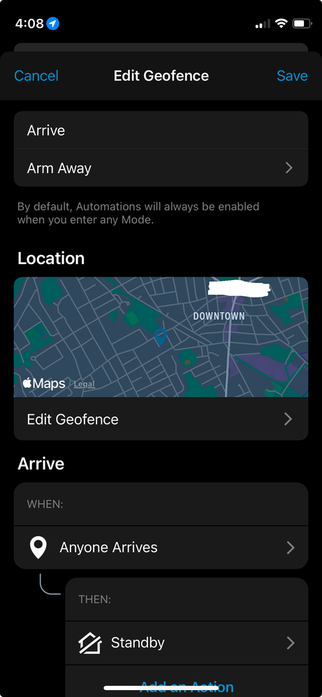

And use these for the two geofencing automations:
The last setting on you list or my arrive is not working with this setup. Arriving from away does not put the system in stand by
Does it work when you test the automation?
Double-check that the enable list is set to be always enabled.

The schedule should work if you have the system set to either Arm Home or Standby.

Here are all of my settings. Arm away does not seem to disable when we arrive.
Thanks. These all look correct.
The issue might be "specific people arrive". Try "anyone arrives". Review the available geofencing devices, and remove any duplicates, old devices, and tablets that don't travel.

@Pats6XSB wrote:
Tried everyone arrives and it does not come off of Arm Away with the settings you provided. I also checked that there is only two devices (phones with different names) available for geofence.
There is no "Everyone arrives". Do you mean "Anyone Arrives"? Or "Specific People Arrive?"
"Anyone Arrives" is working on my iPhone. Have you double checked that the arrive automation is enabled in "Arm Away"?
