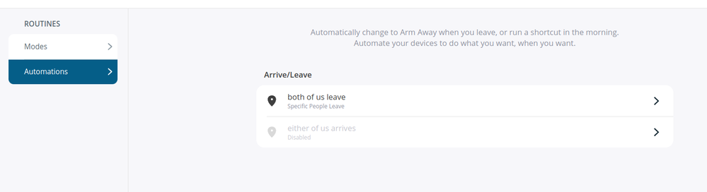

Well, I never thought this day would come, but I'm happy to report that both automations of Away and Home transitions are working correctly now with all my cameras including the old Arlo Qs, with the new Arlo app. I will close the case after verifying things for another week.
Here are my settings (in the "new" Arlo app, installation triggering is described in further up in the topic). One breakthrough happened when I deleted all my old settings and re-created them fresh a couple days ago.
Modes:
1) Arm Away
2) Arm Home
3) Standby (is not used by the automations, but I can manually trigger it, which causes the system to no surveil anything)
Automations:
1) "both of us leave" [<-my label] - People Leave - enabled only within Arm Home mode (I turn off the other two modes) - When: "Specific People Leave" [make sure you've deleted all devices but the ones that are tracked moving in and out of the geofence] Then: Change Mode to "Arm Away".
2) "either of us arrives"[<-my label] - enabled only within Arm Away mode (I turn off the other two modes) - - When: "Anyone Arrives" [make sure you've deleted all devices but the ones that are tracked moving in and out of the geofence] Then: Change Mode to "Arm Home".
Make sure the phone allow Arlo to access the phone's location in your phone settings.
Thank you for all your help.
@ejahn Thank you for the update.
Can you maybe post screenshots of where you’re creating your automations or maybe just a step by step where to click? We’re talking about the Arlo app, right? Not some external controller (ifttt, smart things, etc)?
Sure can! This is just the Arlo App (no third party apps used). Looks like in the Desktop browser app It shows both automations to be "Always On". However, in the app, they are limited to only one mode as described in my last post (I would follow what I have in the app as pasted below):
Automations:
So the two apps don't fully sync, oddly.
Here are screenshots:
