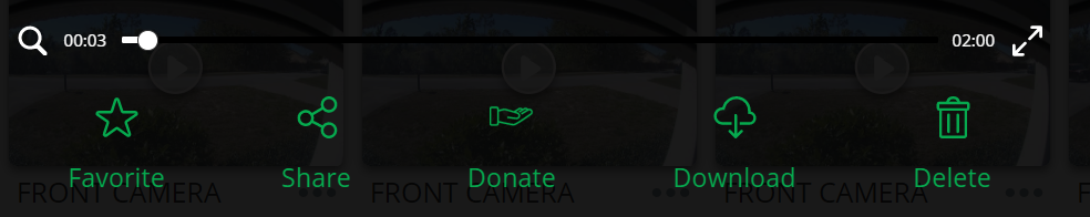

This is unbelievable! My Arlo Q cameras have been showing the wrong recording length for a week now and, today, I was happy seeing the normal amount of 2 minutes which is what I set it for. However, when I clicked on clips to view, it now only show 3 to 4 seconds of recording. It will not allow any viewing after that!

Here is a snapshot of the newest problem today >> The camera now automatically stops at the 3 second mark when I try to review the 2 minute recorded clip.
