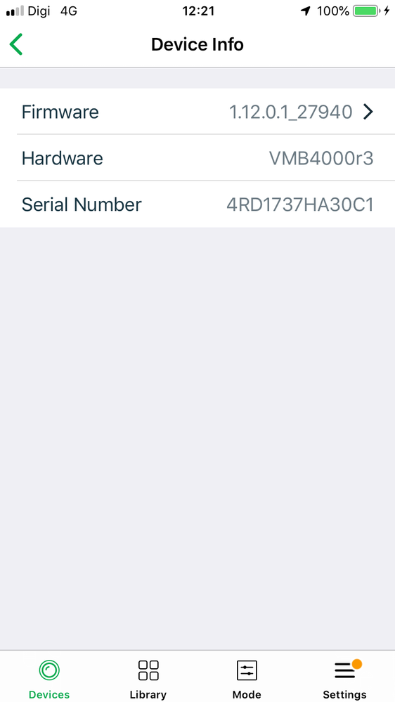

I am experiencing the same issues. I suspect that the April 19th Arlo Pro Base Station firmware update has broken my entire Arlo system. I have a VMB4000r3 base station and was receiving recordings and able to live stream my cameras until the early morning of April 19th (last recording was 2:14AM). After the latest firmware update, I am no longer able to connect to any of my 5 cameras for live streaming and recording has also stopped.
I have already attempted multiple times to power cycle the base stations and cameras, remove and re-synced cameras, and I have even performed. a factory reset of the base station and re-synced cameras. None of that has worked.
My camera system is effectively useless now. The VMB4000r3 base station is running firmware 1.12.2.0_2794, and the Arlo Pro (H7) cameras are on firmware 1.092.0.19_26228. This is absolutely ridiculous.

My firmware is 1.12.2.0_2794
