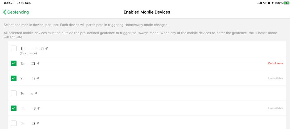

After a long and hard battle, I had managed to get geo-fencing working with my iPhone and also my wife's. We're both retired so we are out and about a lot and, frankly, it was geo-fencing that sold us on Arlo. Some occasional glitches but nothing I couldn't cope with and generally speaking it has worked quite well. Now, I'm faced with having to re-enable my wife's phone because, in Legacy, my 2 enabled devices has become 1. So I go in and I try to re-enable my wife's phone. She has access, her details are there, her phone is listed and i tick the box. But no joy, it says it's "unavailable" later followed by "use the new Arlo app to modify geo-fencing settings". So I go in there, still only one mobile device enabled, my wife still has access but now her phone isn't listed so I can't add it. Frankly, it was hard enough trying to get geo-fencing to work on one app; it's near impossible for me on 2.
Please can support provide an idiot's guide to how to re-enable mobile devices for geo-fencing since this is the main area affected by the change of app. And a problem area identified by them beforehand.
SECOND DEVICE IS STILL UNAVAILABLE

Geofencing is what encouraged many of us to opt for Arlo in the first place, yet it has been an area fraught with problems. Now we have the system change which has added to the problems and we only have a couple of weeks to sort it out. My wife's phone is/was an enabled mobile device on my Legacy app. It is on the list of enabled devices but is currently "unavailable". Now I know that is a result of the change but I haven't been able to re-enable her so, in reality, the system is useless until that gets fixed. Now, that may be down to my lack of understanding but I did manage to set it up in the first place. On the new app she is still shown as an "Accepted" friend but her phone does not appear on the list of enabled mobile devices at all.
Can I suggest, please, that you get Support to put out an idiot's guide to resetting geofencing and re-enabling phones on the new app since this seems to be a problem to many users involving as it does 2 different apps.
I've looked at the "How do I add and manage multiple mobile devices for geofencing?" and "How do I add friends to my Arlo account?" articles but they don't seem to cover the changeover situation.
The problem Arlo has is that if it doesn't get this fixed PDQ then come 1 October it is going to have a lot of unhappy customers. Not a good start for a new company.
One final request, please. How do you get rid of "enabled mobile devices" you no longer have/want?

I would love to tell you how the problem was fixed but I can't. What I can say is that the when I had the problem, Legacy listed 6 enabled phones, 2 of which were ticked but 1 of them, my wife's, wasn't available. The new app showed 2, only one ticked the other not available. Geofencing worked on neither. Suddenly, a day or so later, both apps moved into sync, both showing the same devices, the same status and geofencing working on both. I was fiddling about with it at the time, my head in a spin, but am not aware I did anything to change the situation. Perhaps that will make some sense to you.
So, I currently have 2 working apps. I was going to delete the Legacy app but given the changeover problems I have left it meantime. I can live with duplicated notifications for a while!
