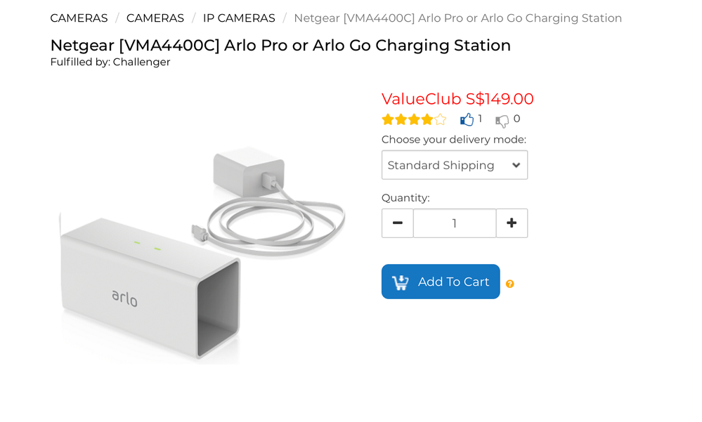

And I have realized why the original charging cable is "suddenly incompatible" with my Arlo Pro cameras.
Arlo has come up with the new Arlo Charging Station (see attached photo), which basically means if you want to continue using your Arlo cameras bought previously, you are forced to buy the newly-marketed Arlo Charging Station.
(Go figure 🙄...)
FWIW, The documentation for the charging station says it can be used with your existing power adapter/cable.
Since you've tried multiple cables, multiple cameras, and multiple batteries, what's left is the charger itself. The charger for the Pro uses 9 volts, so normal USB chargers won't work. So I think you'll need to either need to convince Arlo support to send you a replacement (it is covered by warranty), or just purchase a new one. US street price is about $15 at the moment.
