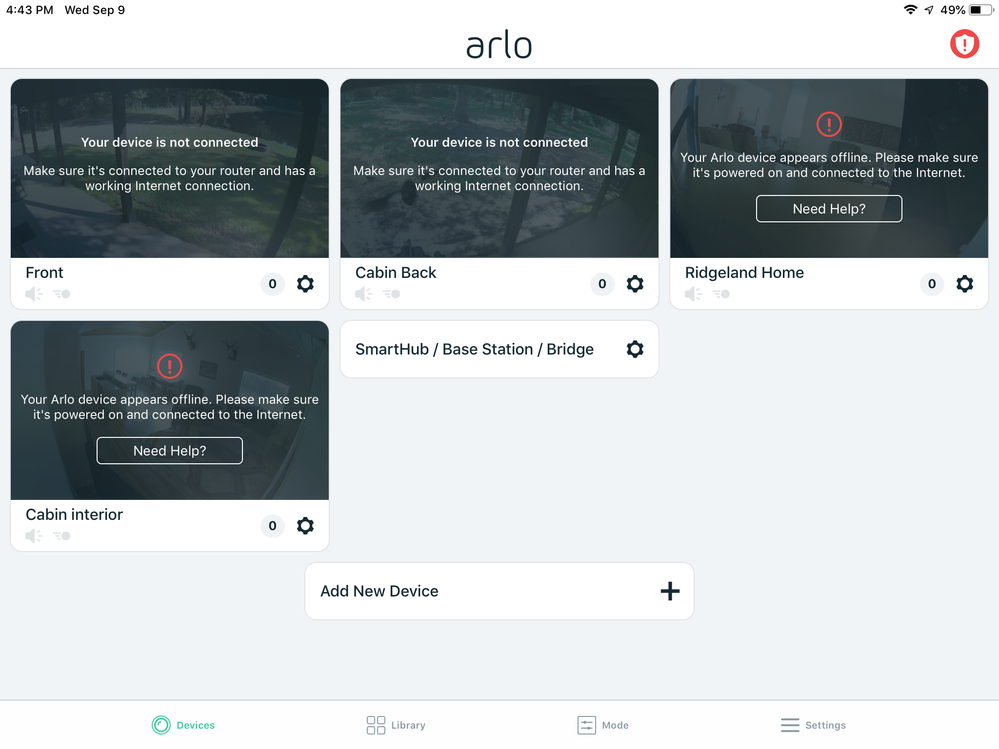

Having the same problem over several devices is different locations far apart. It would seem to me it’s an Arlo network problem. Here is a screenshot.

I’ve tried to post on this conversation and even replied to you with a photo of the problem. Any close to Arlo resolving the issue? Can’t seem to get any reply. Great customer service!
