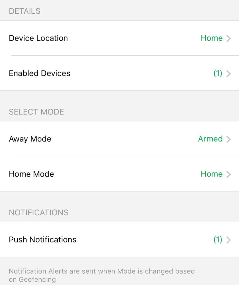

Really Netgear?! You can only attach one jpeg?!! Who planned your support portal?!
JPEG shows only one device enabled so it's not an issue of multiple devices confusing the system. Device location is recognized as home and if that's the case the mode should be home not armed.
