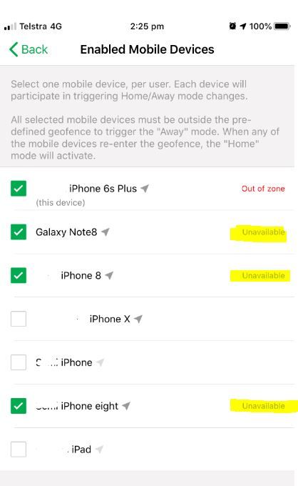

Looks like Geofencing is broken again for unkown reason since late late week~early this week.
All Shared Devices's Location status no loner visable on Geofencing setting page (see attached screen capture)
All iPhones all on iOS v13.1.2
All iOS Arlo App version 2.9.1(1134), Release 19 Sep 2019
My Samsung Note 8 is on Android Arlo App version v2.9.2_25930, Release 23 Sep 2019
Went through the usual device reboot, chaning mode & remove/add devices on Geofencing setting page .... bla bla bla all the usual trouble shoot steps after two days, and still no go.
I've check all shared devices's Location Services are all set to "Always" & Back Ground App Refresh to "On"
