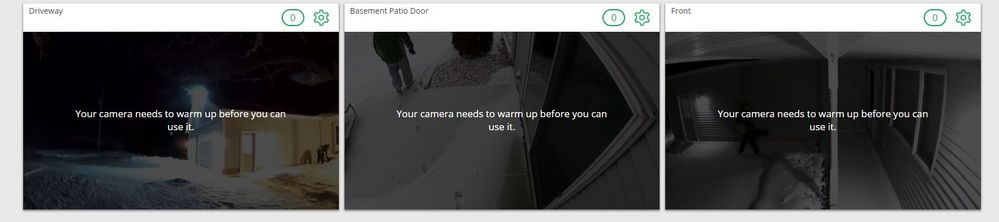

It’s late January in Northern WI. Temps can consistently reach below -4F operating limitiations. Can I leave device outside in -15F or greater without damaging? Noticed device quit working around -4F. At what temp will device begin to operate again? Does it need room temp to warm back up, or will it operate again at lets say 2 degrees? Thanks!
No harm, no foul. The camera will start operating again on it's own when it warms up. I don't know how much hysteresis is built in but I think a few degrees above -4F will allow the camera to operate again. I have one offline right now due to cold and will be watching to see when it recovers.

Really looking for the operating range, temperature wise. My cameras are easy to take down and I would prefer that to waiting until noon each day for the things to turn on.
It is up to -9 here and one out of the three cameras is working again.
Found the manual on the Arlo site. Range for my Arlo is -4 to 113F.
