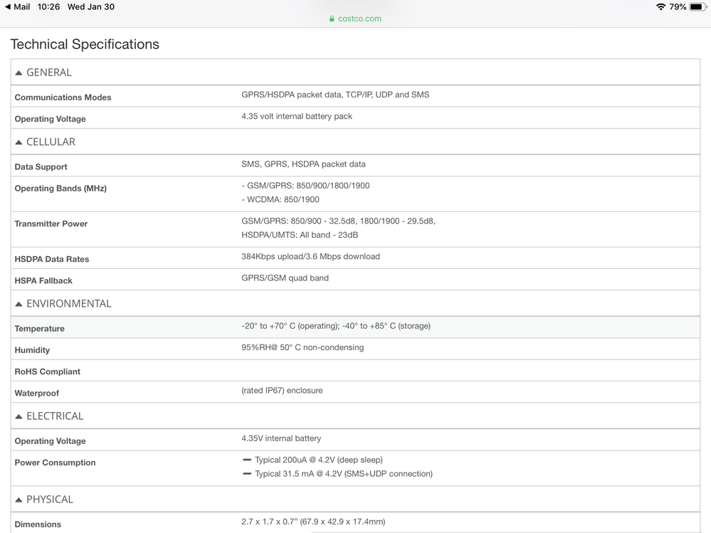

There was a Medical Guardian device sitting on its charging station next to the base which I had suspected. It uses both GPS and WiFi to locate its position. I moved it about 10 feet away but it didn’t seem to make a difference. The third camera is sitting about 10 feet away from the base which never had a problem. This old house also doesn’t have drywall but the older type if that makes any difference. I took a pic of the spec of the Medical Guardian. It doesn’t seem to use 2.4
I agree - the Medical Guardian doesn't seem to be the issue.
