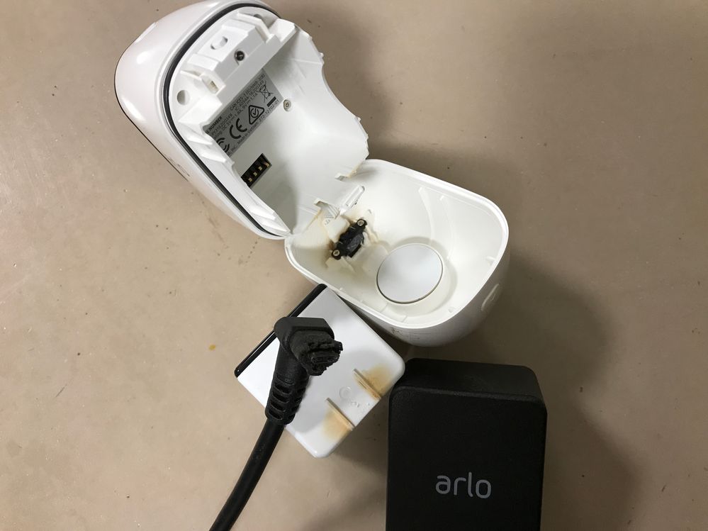

Hello
Just a note of caution, I had exactly the issue described on Amazon's email.
The Camera and the Power Connector burnt.
Pls see pictures attached.
Opened a case with Netgear help desk, wating for a resolution.
[]s
Wow! Haven't seen that before. I had an issue with water getting into the camera connection and causing corrosion but nothing like this.

Yeap! Check-out Amazon's cutomer review on this item. There is another picture very similar with my case.
His description is eaxcatly as mine, the camera and the power adapter connector burnt.

We’re you running the camera in CVR mode when that happened ? Just wondering if a constant, long-term, high power power current flow triggered the burn ?
Hi
No CVR mode, only the basic plan with short video storage.
[]s
Adriano
aandreol wrote:Hi
[]s
Adriano
Was this with Arlo Pro or Arlo P2 camera?
