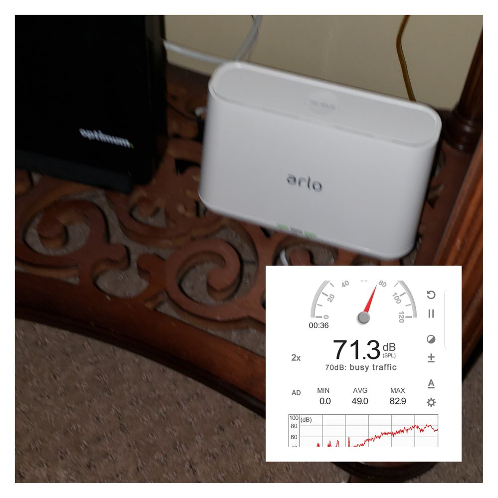

Thanks jguerdat. I just tested ur theory and you are correct. When I manually turn on the alarm through a web browser, it is loud as usual. Using my Android app, it is absurdly low. So I am to assume this is an app related issue and no explanation why? Weird!
See my photo of just how. loud the siren is when using the Android app.
