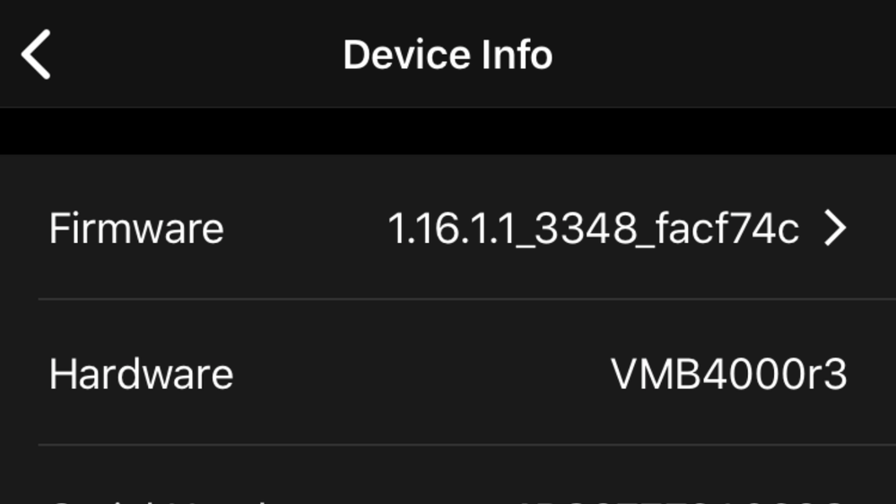

Having a similar issue as previously mentioned that it never properly connects and just keep getting the "connecting" message. Using IOS app (latest updates) with Firmware 1.15.0.2_371_f7780e1 for the smart hub (Version VMB4540r2).
