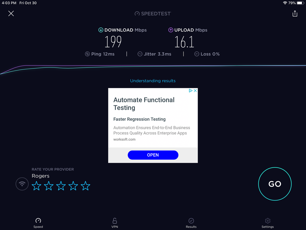

last case #42035376 got disconnected from that as well. Last question I was asked was to perform a speed test of my internet (i do have a high speed 150 Mbps and test result came to 199 Mbps) and upload screenshot, just as I got disconnected. Maybe my internet speed is too fast? 🙂
Attached is the screenshot.
it appears to me they’re on the wrong track if that’s the type of question they ask.
