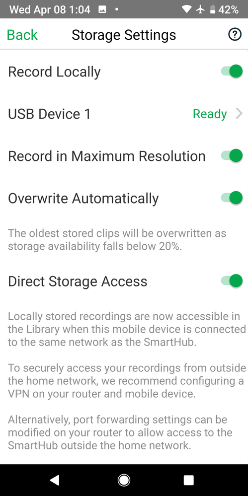

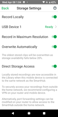

Prior to latest Arlo Android app updates I was able to access my local storage connected to Smarthub using the Arlo app - this was working perfectly, there have been no other changes to phone or home network.
When I go to Library page I no longer see the options (above the date) for selecting cloud or local storage.
I have all app settings turned on for local storage and USB Device 1 is 'Ready'.
I have removed USB device and confirmed that files are being recorded there.

I have loaded latest Arlo app on 3 phones on same home wifi network and I get identical results with all.
Please note - port forwarding does not need to be enabled when accessing local storage on same network as Smarthub - it was not necessary before when this was working for me before and it is clearly explained in Arlo's instructions.

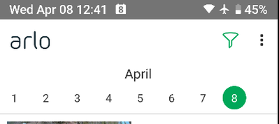

I do not get anything at the top when in Library to hit unfortunately - screenshot shows what I see at top when in Library.

Your pics didn't go through. its right  above " april " on iphone. after i updated it just said library till i hit it. Just went back and checked and ow does says cloud or smarthub like it used to.

Pic attached.

I have the exact same problem.  I am accessing local storage from my 2 Galaxy S7 phones.  Never had a problem before.  This actually started a day or so ago.  There is no Smarthub or Cloud area to press above the library anymore.  There must have been a firmware update that screwed this up.  The only thing shown at the top is April.  There must be lots of others with this same issue.  Why is everyone silent?
