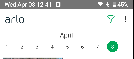

Ricer
I do not get anything at the top when in Library to hit unfortunately - screenshot shows what I see at top when in Library.

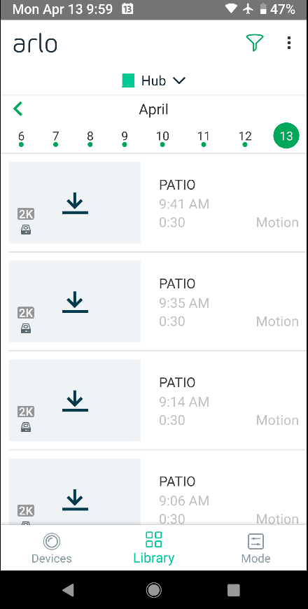

Ricer
Yes, that is where it used to be for me on Android app.
I can make it appear for one app session only if (as I said in OP) I enable port forwarding. If I close out app it will be gone again until I disable and re-enable port forwarding.
I appreciate your help but comparing iPhone to Android app is not valid.
Pic attached.

vnorred
I have the exact same problem.  I am accessing local storage from my 2 Galaxy S7 phones.  Never had a problem before.  This actually started a day or so ago.  There is no Smarthub or Cloud area to press above the library anymore.  There must have been a firmware update that screwed this up.  The only thing shown at the top is April.  There must be lots of others with this same issue.  Why is everyone silent?

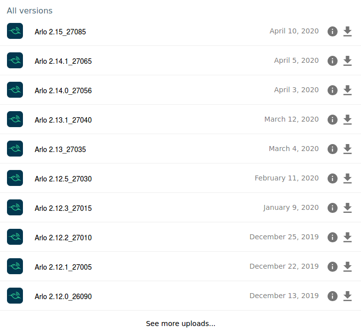

Ricer
Just confirmed my suspicion that Arlo broke local storage with their app updates - installed an older version of Arlo app (from March 04) and local storage is now working 100 percent, same phone same network. I am still waiting after many days for a response from Arlo Support on this problem.
vnorred
Glad to hear you are back in business.  Mine on my Galaxy S7 seems to work 90% of the time so I can tolerate it for now.  However, your comment interests me.  I see my Arlo app was updated on April 5.  I did not know you could revert to an earlier version, i.e. April 4.  How did you do that and how do you prevent it from updating automatically again?
Ricer
It is possible to install app APKs (packages) from other sources. There are security concerns with this and it is not really recommended - would just be better if Arlo tested more thoroughly before releasing 'updated' versions.
https://www.theandroidsoul.com/how-to-allow-apps-installation-from-unknown-sources-on-android-9-pie/
You can turn auto-updates off in Google Play, that gives you control over which apps are updated and when. (manual updates)
