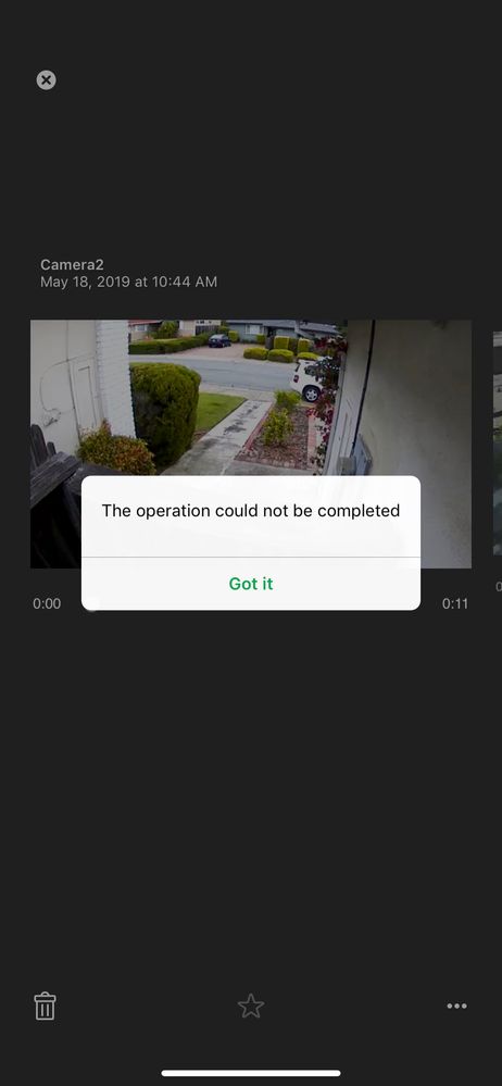

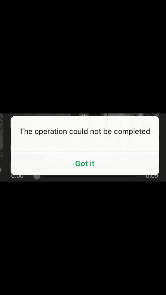

I keep getting this message operation cannot be completed at this time does anyone know what this means
I have arlo pros
I have an iPhone 7
I run IOS 12.3
I am not trying to store anything at this stage. The videos will not play on the iphone app.

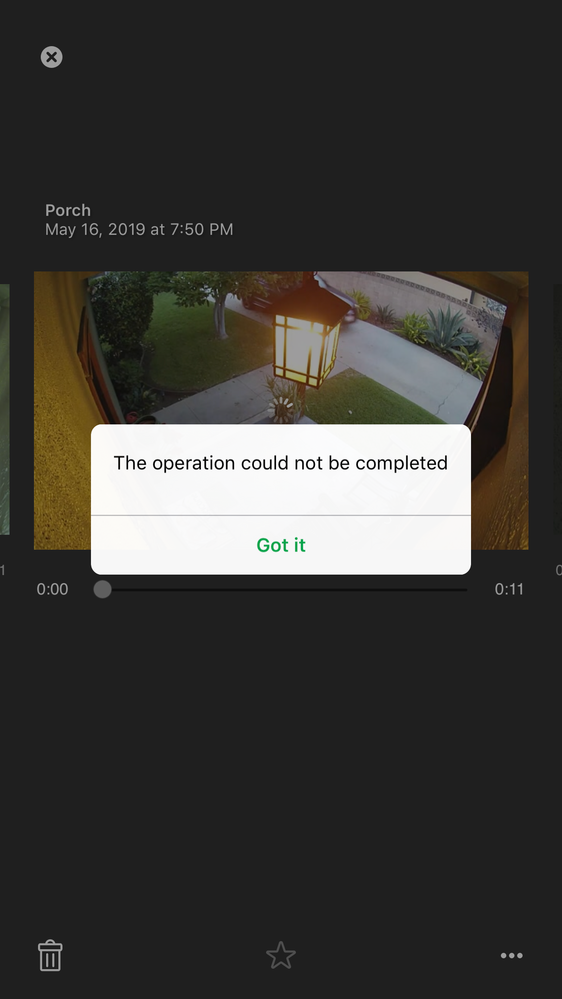

Attach a screenshot of the error message received.
“ Attached. “

Screenshot of error when you attempt to download the problem video using iPhone App.

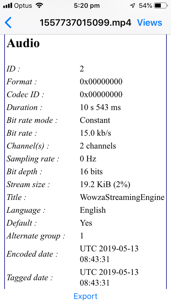

Attached Screenshot of file header audio information shows missing format and codec information.
Should be
Format : AAC LC Advanced
Codec ID : mp4a-40-2

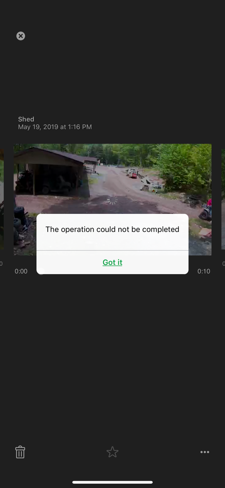

- Attach a screenshot of the error message received.
- File attached...and seriously...You can't attach a file with a *.jpeg extention??? I had to save it as a PNG

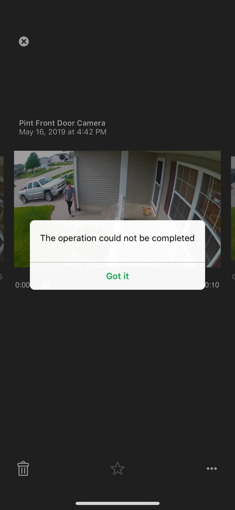

The failure to play is only occurring on my cabled cameras, so far not on battery only cameras.

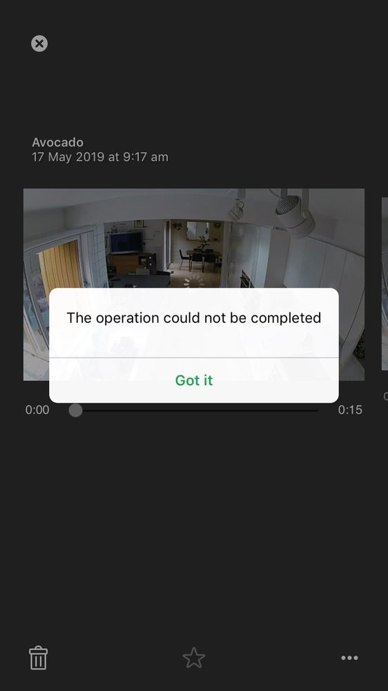

The camera that fails for me is not on 120v. it is on battery power (still over 80%). Like others, I can download the file and open and play with VLC (Quicktime will fail). VLC will throw a warning though. It says "Codec not supported. VLC could not decode the format ' (No description for this codec)"

Thanks for providing the information we need to share to our engineering team. Our engineering team is investigating this issue and we'll provide an update as soon as we have more information to share with the community. We appreciate your patience and understanding.
The operation couldn’t be completed. (Cocoa error -1.)
