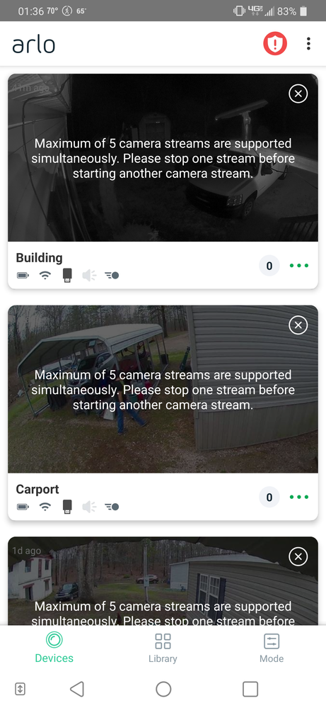

I am getting a message that there is a maximum of 5 cameras streaming anf I need to stop one in order yo get a live view of what my cameras are seeing. I have been able to pull up all 8 at one time but now this is all I can get I am attaching a screen shot of what the message actually says. Can anyone advise what to do to fix this and has also changed something I am unaware of ? This just started tonight 20 March 2020

I'm getting same error and I only have 3 cameras. Nobody else streaming at the moment and there is no recordings of activities in the last 3 hours
Im getting this error message on two separate base stations at remote house, Is there an issue with cloud? Maximum of 5 camera streams are supported simultaneously. Please stop one stream before starting another camera stream.
Maximum of five streaming, stop one streaming before starting another one. Already rebooted base. Does not help.

When I try to watch any of my cameras live streaming, I get a message that says, "Maximum of 5 camera streams are supported simultaneously. Please stop one stream before starting another camera stream."
None of the cameras are streaming, and nothing has recorded since last night.
I received the same message as listed above with only having 2 cameras in my system. I tried everything listed in the other comments. Last resort was to remove the cameras from my system and add them back into the system. This appears to work, I now am able to live stream and now getting video captures when the camera is tripped. Will monitor to see if this occurs again, but for now my system is back up and running.

Worked like a charm. Thank you.
Removing and readding one of the cameras fixes the issue.
