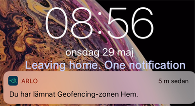

I have the same issue... But the other way around.
When I leave home I get one notification I left the Geofencing zone. But the system won't arm. I have to select another mode and then geofencing again for it to arm successfully.
But when I re-enter the zone, I get two notifications. And the system disarms directly.
I have two iPhones, both running app version 2.7.10. Attached two photos, in Swedish but you get the idea. Base station is VMB4000r3. The modes for geofencing is only "armed" and "disarmed" so no custom.
