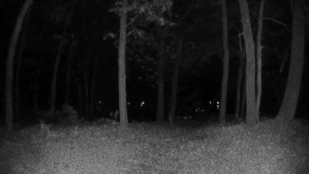

here's a pro2 night shot...
small stump in center is 25 ft away or so cam is 6ft high
here's last night ...raccoon ( not as sharp )

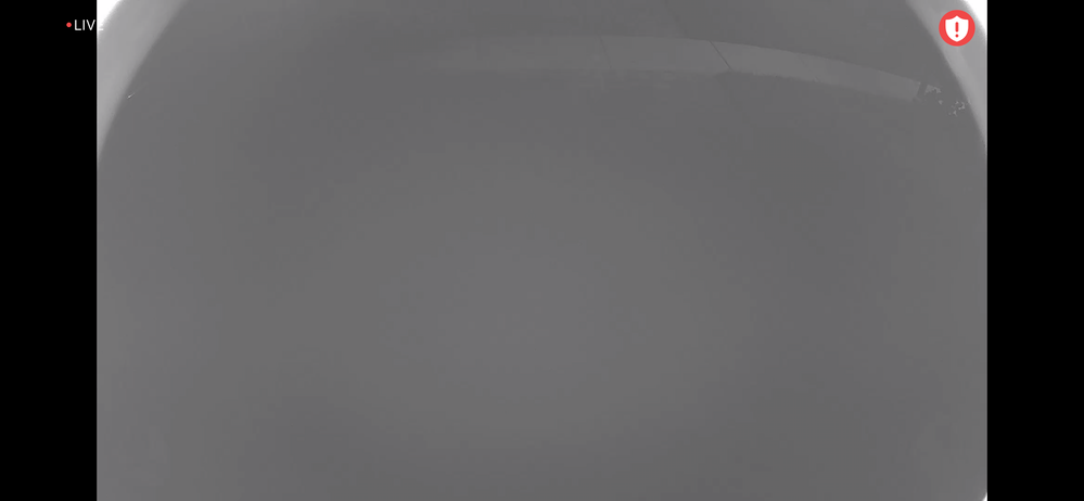

so i just installed my Pro 2 outside and at night its horrible, its dark and its grey. I walked back there and still cant see much. When i toggle the night vision on and off it looks exactly the same. this sucks.. I have an Arlo Q inside and i can see everything great and clear in middle of the night...
just hooked mine up outside and same exact issue.. pissed off. I have a Q inside the house and when it is pitch dark it looks amazing.. customer service wants me to send photos but what good is that going to do? from the forums here it appears its a design flaw
Brightness makes zero difference, and strangly enough, when i toggle the night vision off on my phone the picture looks exactly the same...no difference
how close to gutter downspout will not be an issue? I just see grey fog as well but my camera is mounted roughly 8 inches from the gutter
i have no covers on my camera, its naked... and its all grey and washed out still
