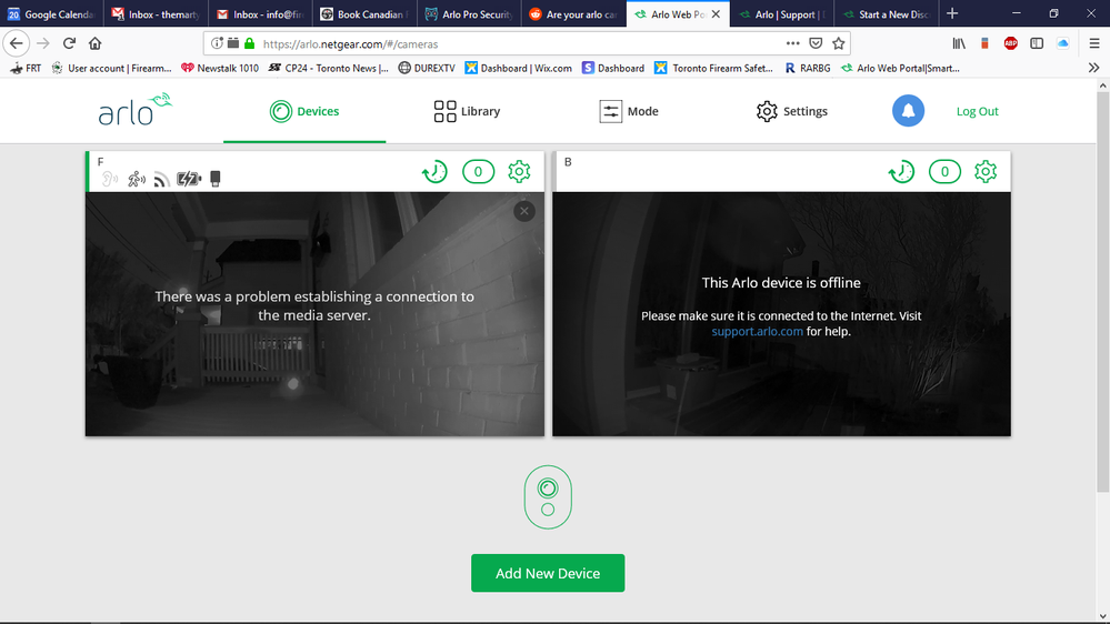

This is happening everywhere, Im in Florida and my son is in Texas and he has the same problem. Its clear this is an Arlo problem. I was chatting with them and I did everything they asked me to and nothing. She told me its happening to many, some have been fixed but others still not working. THIS IS A MAJOR SECURITY PROBLEM! Many of us depend on these cameras for our safety. Arlo needs to fix this asap!
Mine has been out from Friday after a firmware update. Also in North America (EST).

I am in Vancouver so west Canada. I am unclear if this was a firewall issue or not.. It seemd like I changed my firewall to Minimum and it began woring but it was right after I made this post. Is there a change they changed which UDP [ort Arlo uses or somthing? Is there anyone actually AT Arlo? To be honest if I know that my camera system relied on their servers to be up and running to work I am not sure if I would have bought this system. I have 5 Cameras and so far it has worked pretty well until this. They will have a class action lwsuit on their hands if they do anything dodgy in the future but they really are the ones in control of my camera system and it kind of sucks. It is working now so if oyu are having the same problems decrease your firewall strangth and reboot your router. That is what I did and it began working but I have the same router etc foe years at a high security setting and it always worked fine.

Hello everybody, I just got a new MacBook and am trying to look at my Arlo cameras. I was a little disappointed when I saw there isn't an app you can download like the iPhone. So I went on line to the website and had to download Adobe. Now that I downloaded Adobe it says "There was a problem establishing a connection to your media server." Any suggestions thanks guys.
On Friday 4/19/19 we released firmware for base station models – VMB4000, VMB3500 and VMB3000. Some customers have reported seeing error messages when live streaming and issues receiving motion recordings. Due to these reports, we are rolling back this release to the previous firmware version (1.12.0.1_27940) while we investigate these issues.
If you begin experiencing one or more of these symptoms, please power cycle your base station and confirm that your firmware has reverted to v1.12.0.1_27940 – found under Device settings. To power cycle, choose the ‘restart’ option under your Device settings within the Arlo app or by unplugging and re-plugging power to your base station.

Seems like we are back in business. Arlo team reverted firmware back to V1.12.0.1_27940 and I am able to connect to all my cameras again after 3 days. Just need to power off the base and turn it back on and it will revert back.

Our system runs again after a restart of the base station and "update" to version v1.12.0.1_27940
Just performed another base station reboot. The Arlo app was then indicating that a firmware update was required, which I did. Version of the firmware is now 1.12.0.1-27940. Now the live view and notifications are working as expected.
