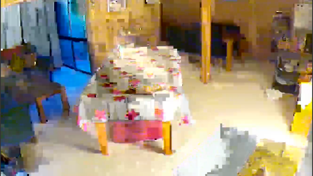

I got tired of always having to take down my camera to charge it so I ended up buying an outdoor charger for it. Well now at least once a day the camera will start recording and it’s all kind of wavy and distorted. Then it will stop recording until I end up restarting the base station. I don’t really know what to do cause I like not having to charge it, has anyone else experienced this?

Yes, do you get something like in the attached video before the camera stops live viewing?
Yes, that’s exactly what it looks like!
