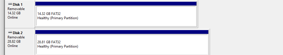

Hi everyone,
Recently my free cloud recording storage expired so I tried to set up local recording by inserting USB flash drives into my HUB (VMB4000r3). So after some time I wanted to try to read these USBs but Windows 10 wont see them at all. Wehn I look at the disk management i can see drives there and since I cant access anything on these drives since Windows doesnt see it in file explorer I wanted to format them using disk management but error keeps showing with error "system canot find the file specified) . Did anyone have  these issues?
Thanks

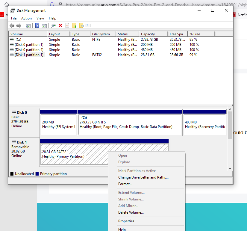

Can't see the image until approved but you can use the paperclip icon below the text box to attach it so we can see it immediately.
stribor45
see attached
Use Delete Volume to get rid of the partition.
stribor45
Should I go thru the wizard to create new volume?
That should be fine but you may need to format the drive in your base to get it to work with Arlo since W10 really doesn't want to allow the use of FAT32 - it'll likely give you a choice of exFAT or others but not FAT32. You just want to use a basic drive, nothing fancy.
stribor45
ok I will try that and let you. What file system should I use?
stribor45
that didnt work for me but after multiple try of using diskpart command line tool i was able to clean it and than format it using disk management.  Once I put this USB back into my hub should I format it using Arlo tool?

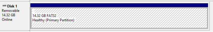

So I  put the drive back into the hub...
  1. Formatted it
  2. Arlo didnt report any errors beside "ready"
  3. I can in hub local settings that some storage has been taken by the videos
  4. I ejected USB using arlo app before I  unplugged it from the unit
  5. Instered it into port on my Windows 10 machine
  6. Drive is not seen at all by the file explored
  7. It is seen by the disk managements (see image)
stribor45
sorry attached wrong image. this is the image...
