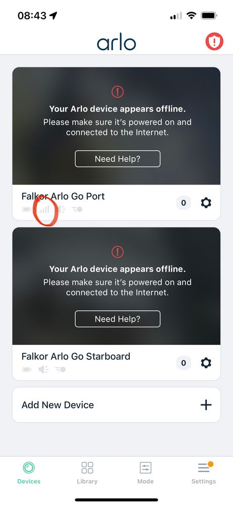

I have 8 Arlo Go cameras in various positions around a field. Two of them are always going offline. I've changed their positions, cleaned the sim cards, done factory resets, put them in the same positions as other cameras but still they go offline. Any suggestions would be most appreciated. Thank you.

An update is now starting to roll out for Arlo Go users who experienced offline issues with their camera. We expect it to reach all Arlo Go cameras in the coming week. Users may need to reboot (remove/re-insert the battery) and recharge the battery to receive the update, if your camera is already back online, no further interaction is necessary.
Additionally, we would like to clarify that this issue was not related to the 3G shutdown that has occurred on some carrier networks.Thanks for your patience and understanding. We'll continue to closely monitor your feedback to ensure your issue has been resolved.
