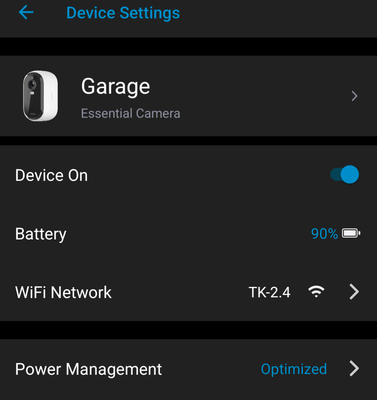

Just a SWAG here but maybe try 2 things:
1) Proactively charge the camera so it never reaches the threshold to switch to Low Power Mode.
2) Disable Low Power Mode in the camera settings under Power Management so this doesn't happen again.

I fixed it just now by going to the app
Hitting the cog menu on the arlo doorbell
Clicking the big title ( what you named your camera)
Clicked restart
And it seemed to do the trick ( for now) hopefully it last.

Restarting the camera restored video recording functionality on 3 of my cameras that experienced this annoying issue. From the app click on the settings (gear) icon of the camera, click on the name of the camera, then click on "Restart" at the bottom. Toggling "Device On" does nothing, I had to restart it as mentioned above. Once restarted, it was recording video properly.
