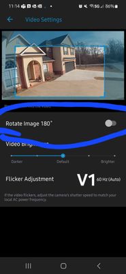

You are correct. It should be there but it isn't. It shows on my v1 cameras but not in my v2 cameras. See attached photos

@photoghog : I believe @BrookeN might be wrong on this. I don't think the Gen 2 cameras have ever had the rotate image setting. FWIW, I am not seeing it on my own 2nd Gen camera either.
You are correct StephenB the Gen 2 are not.
