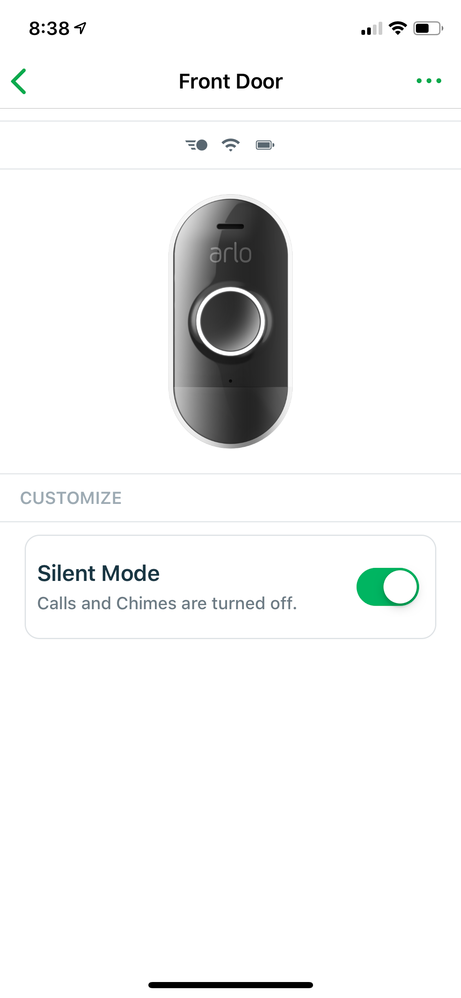

I have tried setting up the Arlo Doorbell to my existing connections.  Like other users have stated, there's a constant buzzing on 1 and 3 with nothing on 2.  The solutions I've seen on here indicate a Traditional Chime toggle switch in the settings for the doorbell, which I do not have on my app.
Under customize, I only have the Silent Mode option.  When that is active I get the Incoming Call option.
Nothing I do brings up the Traditional Chime option.

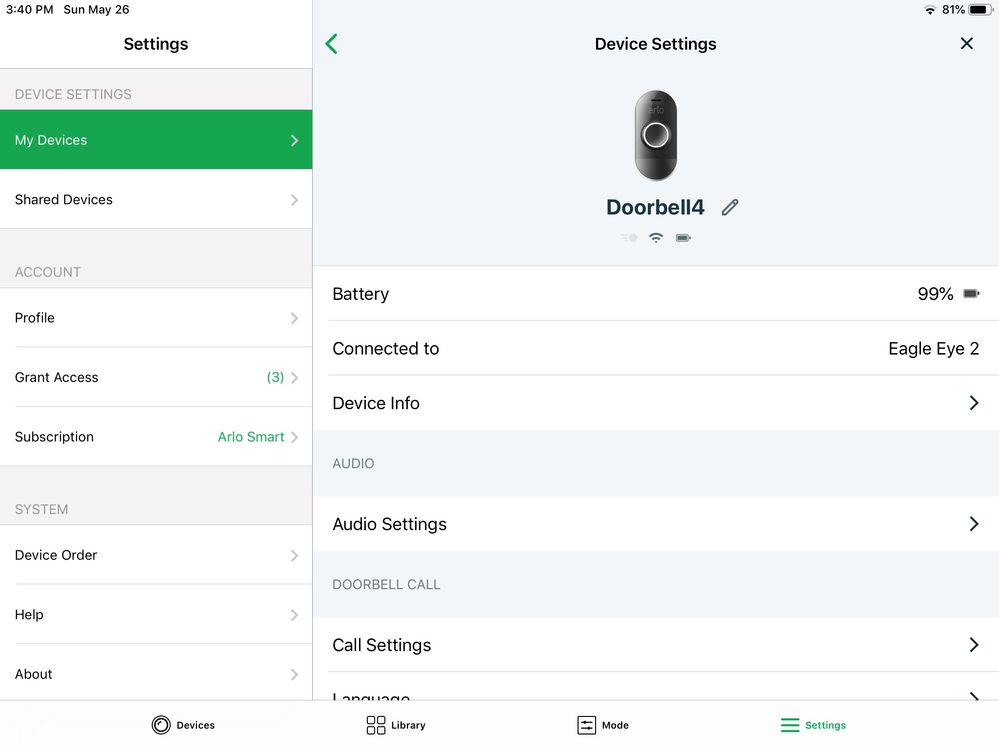

If I enter the device settings, the first section only has Battery, Connected To, and Device info.  No Traditional Chime option there either.
Is there something I'm missing?

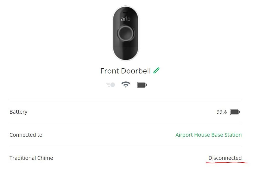

So, I recently received the Arlo Audio doorbell to use in conjunction with my 2 camera Pro 2 system. I was able to get the doorbell physically installed without issue. I was also able to connect it to the base station with little issue. I am still unable, however, to get it to trigger my mechanical doorbell whenever the button is pushed. I have been pouring over the help articles to see if I can find some help and I have narrowed it down to a setting that I cannot seem to get past.
Leaving the switch on the doorbell in anything other than the "2" position gets me a light buzzing in my chimebox that I have heard other people with mechanical doorbells mention hearing when putting it on a digital chimebox setting. So, the switch is in the correct position.
When I log in to My Arlo on my laptop, I can navigate to Doorbell > Settings > Traditional Chime. When I go here, the "Traditional Chime" setting is marked as "Disconnected." I don't have any option or changeable status here. It is permanently stuck in "Disconnected." Is there any way to change this setting?

I have the same issue.  I can see the "Traditional Chime" setting if I log into my computer.  Though I cannot toggle it.  Only on the app you can toggle. But it is not showing up on the app!!!!!
