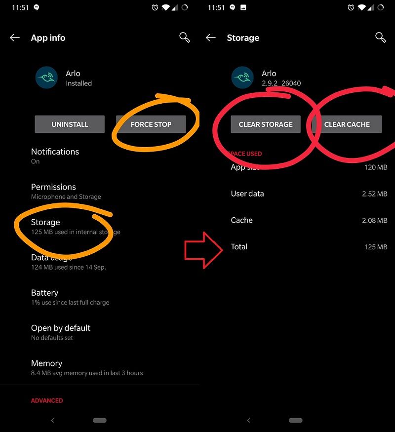

I had the same issue on my Android Phone (OnePlus 6T running Android 9.X) and I managed to solve it by doing the following:
1. Go to Settings > Apps > Arlo
2. Tap "Force Stop"
3. Select "Storage" (this might be different depending on the phone)
4. Tap "Clear Cache"
5. Tap "Clear Storage"
6. Now open the Arlo app and Login again
7. Press the Arlo Doorbell and wait for the phone to Ring. Click "Allow" for any Permission prompts that may pop up.
Attached screenshots herewith to help.
